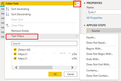

Hi @zcholla
Once you connect to a sharepoint site and see files in the preview window, click "Transform Data" rather than "Combine". This will bring you to Power Query Editor.
You will see a Folder Path column there.
Click Down arrow on Folder Path column header to filter rows based on folder path. You can filter the specific folder you want to connect, then remain only files in this folder.
Additionally, I found a complete guide blog Connect Power Query to a whole SharePoint folder
Community Support Team _ Jing
If this post helps, please Accept it as Solution to help other members find it.
