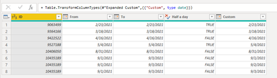

I have a tricky problem with my data set. In the picture below you see the date "from" and "to". This means, that the employee was e.g. sick from a specific date to a specific date. So, only the timeframe and not the single days are given in the data set. But to analyse the data, I need every specific date of the illness of a single employee.
E.g. "ID" number "10435189" , I need instead of 01.09.2021 to 03.09.2021 something like this:
Do you have an idea or a suggestion for me how to solve my problem?

And I think the most effective way is to use {Number.From() ..Number.From()} to get all list of dates between two dates (From and To columns)
#"Added Custom" = Table.AddColumn(#"Changed Type with Locale", "Custom", each {Number.From([From])..Number.From([To])}), #"Expanded Custom" = Table.ExpandListColumn(#"Added Custom", "Custom"), #"Changed Type1" = Table.TransformColumnTypes(#"Expanded Custom",{{"Custom", type date}}) in #"Changed Type1"Output:

let Source = Table.FromRows(Json.Document(Binary.Decompress(Binary.FromText("i45WsjQ1UtJRMtU30TcyRGaUFJWmKsXqRCsZGpgYmAEFLPSNDSFSCFZaYk4xXJWxKVDEUh8qZalvjKImFgA=", BinaryEncoding.Base64), Compression.Deflate)), let _t = ((type nullable text) meta [Serialized.Text = true]) in type table [ID = _t, From = _t, To = _t, #"Half a day" = _t]), #"Changed Type" = Table.TransformColumnTypes(Source,{{"From", type date}, {"To", type date}}), #"Added Custom" = Table.AddColumn(#"Changed Type", "Date", each List.Transform( {Number.From([From])..Number.From([To])}, Date.From)), #"Expanded Date" = Table.ExpandListColumn(#"Added Custom", "Date") in #"Expanded Date"- Fabi1208Frequent Visitor

Hi Fabi1208 ,
Could you please provide some error messages to help us clarify your scenario?
I tried Jakinta 's method and it worked fine on my side.

Hi Eyelyn9,
thank you very much. This works perfectly. I am not sure why the other solution does not work for me, but this one was exaclty what I was looking for 🙂
