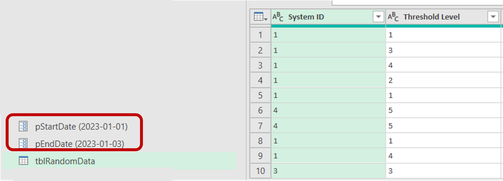

Hi, My question is how I can add a variable number of date columns to an existing table in an automatic way. Context I am trying to create a large fact table filled with test data by using on...

This is easier to do directly in an unpivoted format (you can pivot afterward if you feel like it).
Add a custom column that is a list of dates from pStartDate to pEndDate.
List.Dates(pStartDate, Duration.Days(pEndDate - pStartDate)+1, #duration(1,0,0,0))Then expand this list column.

Thank you so much for that elegant solution. Better than the strategy that I was following.
