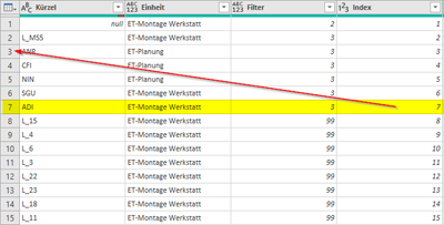

Hello guys,
I have a problem with maintaining the order of each row by adding a index column.
The following table:
First the column 'Filter' is sorted in ascending order.
Based on this step, an index column should now be added. However, adding it discards the order of the previous step.
I have tried unsuccessfully to work with Table.Buffer.
Any ideas how adding an index column preserves the order of the previous step?
Kind regards
Chris

i have find the problem. Some steps before i already had sorted by column Filter. However that leeded to the mentioned problem. After delete this step all works fine. thanks
" After delete this step all works fine. "   ??  What step?
I'm having the same problem with Table.Range(). For some reason, the function don't get the right row informed. And when I used Table.AddIndexColumn(), the order of the table rows changes completely. I have no clue why Power Query doesn't maintain the order from one step to another. It doesn't make any sense at all!
