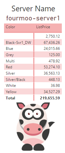

I created my Power BI Report, where I first connected to the Azure SQL Database and imported the SalesLT.Products table from Server1_DW
NOTE: As you can see above my colour has the name of "Black-Svr1_DW" I then created a second table, which runs the TSQL command @@ServerName, this is to ensure that not only could I get back the relevant server name, but that I am indeed not masking the results for this blog post (Honesty is the BEST policy )

  • My final step was to load the data and create a report, in which I could see the Server Details from the @@Servername output, as well as the SalesLT.Product table details as shown below.

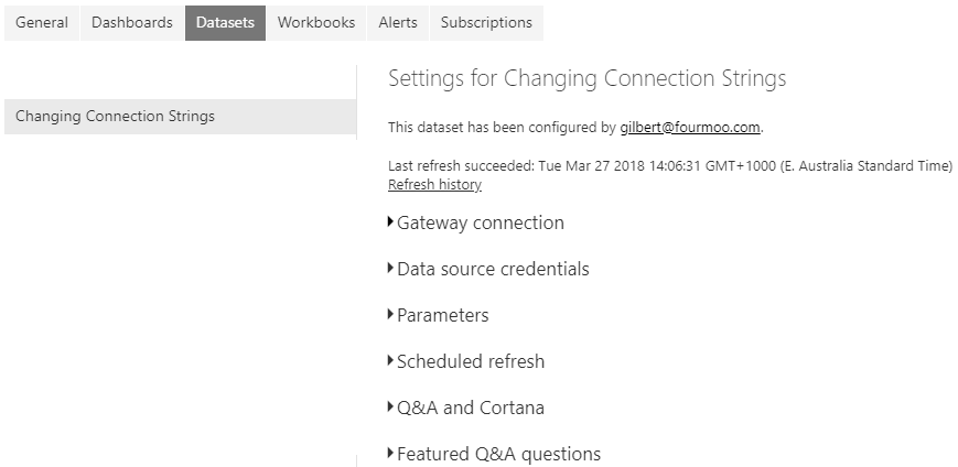

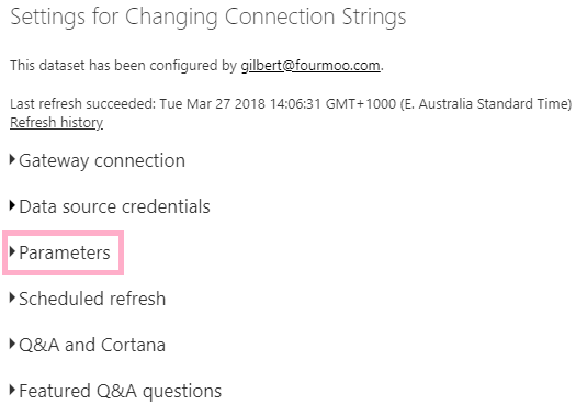

  • Now that I had my report uploaded to the Power BI Service, I went into Settings and then clicked on Datasets.

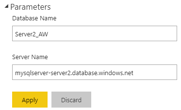

  • I then clicked on the arrow next to Parameters and modified the parameters so that it would use Server2_DW
    • And then clicked Apply

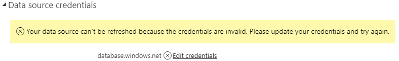

  • I was then prompted to update my credentials to the new database
    • I clicked on Edit credentials and put in valid credentials for Server2_DW
  • I got confirmation that my credentials had updated successfully.

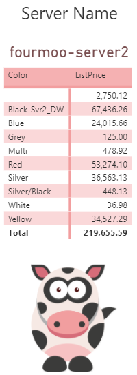

The final step was to refresh the data and see if it now was getting data from Server2_DW
  • I went to the dataset, clicked on the breadcrumbs and selected "Refresh Now"
  • Because I am using Azure SQL Database, the refresh happens really quickly.
  • I was very excited to see that it now is indeed getting the data from Server2_DW
