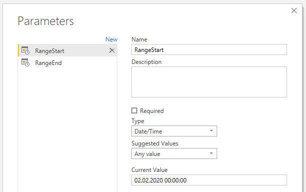

In this group there are also 2 datatime parameters (RangeStart and RangeEnd) – they must have a data type datetime. You should be aware of it.
By the way, I recommend setting both parameters because if you leave them empty, you will not see any data in Power BI Desktop.
