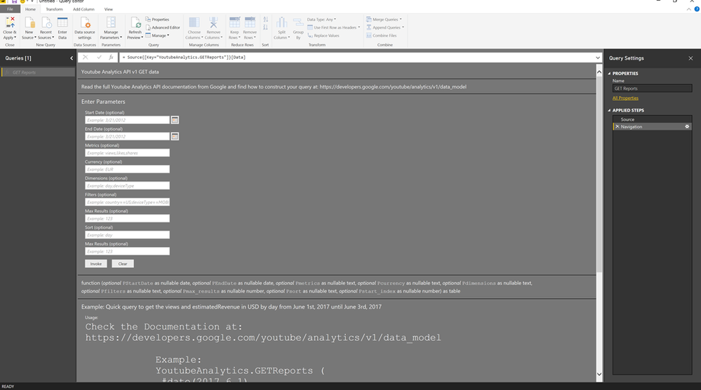

Custom Table Navigation for the elements exposed in the ConnectorCustom Table Navigation for the elements exposed in the Connector
Fully documented function with sample values for parametersFully documented function with sample values for parameters
