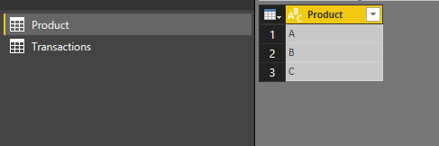

Say you have a dimension table for products:

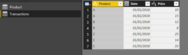

and a transaction table with multiple entries per product:

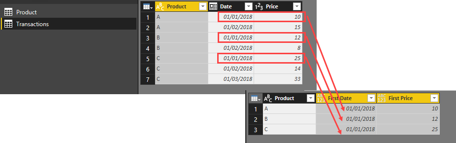

The task is to create 2 additional columns in your dimension table. One to show the first price at which the product has been sold and the other one the corresponding first date:

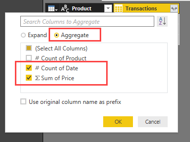

This is very quick to implement if you just want to return one or a few columns from the lookup-table: In the dialogue where you usually expand the columns, check "Aggregate" instead and click on one of the suggested aggregations for each column that I'm interested in (I simply ignore for a moment that these are not the aggregations that I actually need):

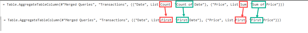

Now I tweak the code in the formula bar like so:
Replacing the default aggregations by what I need (in red: List.First) and adjusting the column names directly in that command (in green: just to save one manual step later).

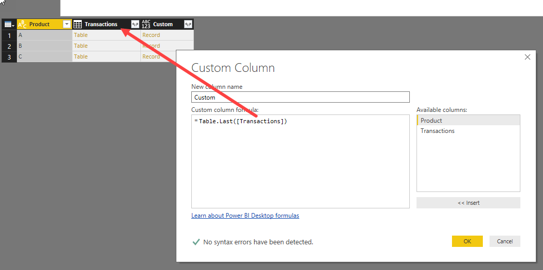

If you want to retrieve many more columns from your lookup table, the method above can become a bit tedious. Then it might be easier to add a column, that grabs the whole first row instead: Table.First would do that job:
Then simply expand out all fields that you need.
