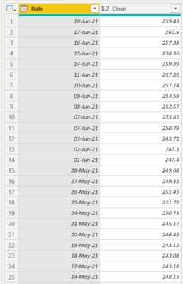

Step 2: Clean up the data and keep the Date and the Close value columns
