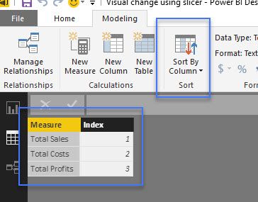

We give each measure dimension an index number as that is what we are going to sort them by in the slicer.
Once this is loaded into the data model, you want to make sure that the measures are actually sorted correctly. You want these to show up in your slicer in a sequential order.
