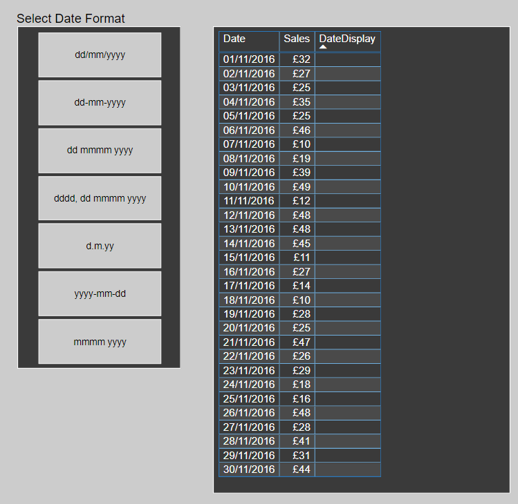

Now, simple task is to move this calculated measure to our table visual:
We see that currently; this measure is showing BLANK values. The reason is that this measure will output a value only when a selection is made on a “Format” column from our disconnected table.
We will therefore create a slicer using this “Format” column:
I have done some formatting to the slicer to show them as buttons, but you can create it the way you prefer it. Let us keep both the visuals side-by-side on the report:

So, when we start making selections from the slicer, our measure “Date Display” in the table visual starts to display dates in the selected format corresponding to the actual “Date” column in the visual. So, that’s a quick trick of achieving this behaviour in Power BI.
