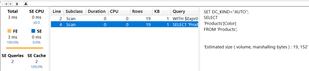

Now if you navigate to the server timings tab you will see 2 xmSQL ( pseudo SQL code, converted from binary to text for interpretation by humans ) queries.
The first Vertipaq query returns a data cache that has a list of Products[Color] and Sales Amount, the #Rows is just an estimate and in reality data cache only has 16 rows which is visible in the Physical query plan.
SQL equivalent of the above xmSQL code is:
Notice xmSQL has no GROUP BY but SQL has and still results are the same! that's because xmSQL does grouping automatically whenever you select a column.
The second Vertipaq query returns a data cache containing list of Distinct Products[Color], and in xmSQL columns are always grouped automatically so there is no need to write SQL equivalent which is
SELECT DISTINCT Products[Color] FROM DataModeling.Products
The first question that comes to mind is why is there a need to get a distinct list of products color in the second Vertipaq query when the result is already obtained in the first xmSQL Storage Engine query? The reason is xmSQL puts Sales table on the LEFT side and Products table on the RIGHT side and only those rows that exists in the Sales table with a matching color are returned, in a scenario where you want to get the colors for which there is no sales you need to put Products table on LEFT and Sales table on the RIGHT side, but that's not allowed as we can't manipulate xmSQL directly.
These 2 data caches are used later by Formula Engine to do a lookup between data cache containing Products[Color] and other data cache containing Products[Color] and [Sales].
Remember Formula Engine can't directly interact with the data compressed by Storage Engine, therefore it needs uncompressed data cache by Storage Engine which is materialized and then stored in memory for use later by Formula Engine, size of both data cache in this example is 1 KB.

Line 3 and 4 indicates the result of second SE query which is list of distinct colors
Line 6 and 7 indicates the result of first SE query which contains 2 columns which are Products[Color] and [Sales]
The Spool_Iterator operator at Line 2 supplies data from the data cache row by row to the Spool Lookup operator at Line 5 and at this point FE does a lookup between 2 data caches
Earlier I mentioned that xmSQL puts Sales table on the LEFT side for getting Sales Amount by Product Color, but Let's say Black color in the data model is missing Matching rows in Sales table, if DAX Formula Engine were to only use the result of the first data cache, Black would have never been included in the final result, but because Second data cache is extracted so we get to see blank for Black color after Formula engine does the lookup between 2 data cache. In the below image 1 refers to first data cache, 2 refers to second data cache, 3 is the result of lookup between 1 & 2, notice that Black isn't in 2 but is in 1.
If xmSQL didn't put the Sales on the LEFT side then a single SE query would have been enough to answer the original DAX query.
