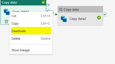

I could not find a way to put a breakpoint in datapipeline.
for example, I have 3 copy activities in the data factory pipeline, and I want to run till the second copy activity, to debug and check data.
In Fabric data factory I could not see a way to put a breakpoint same as Azure data factory.
Please help me with the best way to put the break point to run until a specific activity.

@Anonymous , Thanks for your reply,
I checked it , when we deactivate , it is just skipped, all the subsequent activities are running.
In Azure data factory, we get a red circle at right top corner to stop the flow at the activity. We use that to run until the required activity check the output till that activity and then run from then on.
Here in Fabric DF,  we dont see that red circle at top right of the activity to stop the flow at the activity.
Please help with with such break point in Fabric DF.

I understood your ask and I know about the breakpoint option in Azure Datafactory. But that option is not available in Fabric and hence I mentioned a work around. So wherever you want to stop the flow of the activity , deactivate all the items from that activity. This is similar to breakpoint in Azure Datafactory.
You can check the output after the second copydata . If its correct then you can rerun the whole pipeline. This is a work around option.

Thanks for using Fabric Community.
You can use the deactivate option in the pipeline. Just right click on the required activity and select deactivate.
This makes the particular activity inactive and you can easily debug in this way.
