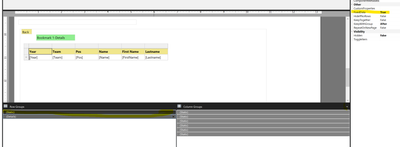

Paginated Report Example:
Tile : Rectangle +TextBox with Action ( Go to Bookmark)
( All tiles are the same with the same action)
Bookmark : Rectangle with Tablix .
Header with scrolling: ( Fixed data: True)
I used this sample data in report : https://www.contextures.com/tablesamples/sampledatafootballplayers.zip
Running report from Power BI Builder works fine. Issue occurs only after publish in Workspace and only when we click the tile which is not in  main window ( that mean - you need scroll down and click tile )
1) correct : after click Bookmark1 :
2) incorrect after click Bookmark 6 :
