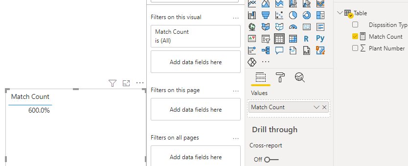

Thank you for the quick reply and sorry for not being clear/providing all the relevant information.  I dont encounter any error message, it is just that the formatting of the measure does not flow through from the original model to the model that has the direct query against the original model data set.
This is the measure in the original model when dragged into a visual:
This is the measure when dragged into the model that has a directquery to the original model data set:
