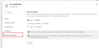

    • DC07's avatar
      DC07
      where? there is a setting for event throughput, but this has nothing to do with message size
      • datacoffee's avatar
        datacoffee
        Icon for Most Valuable Professional rankMost Valuable Professional
        Sorry my bad - I misunderstood your question.
