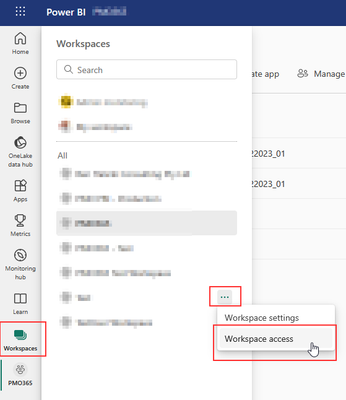

Hello
where i can find "Workspace -> Manage Access"?
In BI I see
And in azure
Hi Sergio,
It's in the PowerBI portal (https://app.powerbi.com)
The portal has changed since I posted the original response, but I think you just need to click the three dots, then there should be a link to update the workspace access.  You need to add the service principal (the application).
Let me know if you are still stuck.
I managed to get the API working, although it is next to useless for what I wanted to do 🙂
