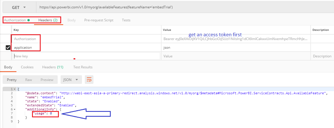

4. About check how much resource left, please refer to the snapshot below.
GET https://api.powerbi.com/v1.0/myorg/availableFeatures(featureName='embedTrial')

Thanks Dale - on point 2, what is the best way to test this on Postman? Is my org my tenant ID? How do I authenticate?
