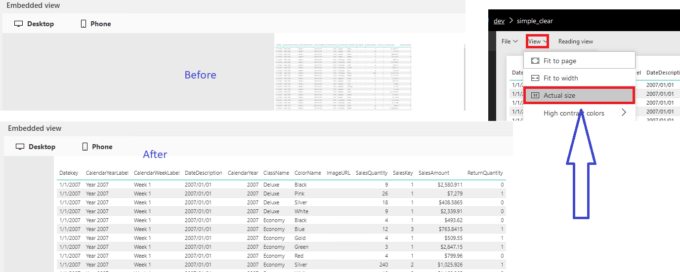

I have created a report on Desktop and have had to create it in a custom page size (due to the length of the report and the number of rows). When you display the report in "actual size" then the report is perfectly visible and you can scroll down and interact. Perfect.
However when you deploy the report through embedded, the report is tiny and you need to zoom in on the Browser. Any way to make the report on the screen the same view as the "Actual size" on Desktop?
Is it an embedding issue or that of PowerBi?
(see attached images from desktop and browser)
browser viewdesktop view

    Hi duggy,
    As we can see from its name, Power BI Embedded, we just embed the contents of Power BI Service into our own application. So we change it in the Power BI Service and we will see the same in the Power BI Embedded. Please give it a try.
    Report_size_and_page_size_issues
