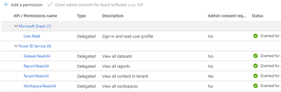

UPDATE: some non-admin calls actually work, but I was not able to make any of the admin ones work properly. I have checked Azure again to make sure I have all the correct permissions assigned, and it seems to be the case:
Is anything missing?

What API Permissions are set up in your App Registration for Power BI? Everything else seems ok.
Hello, at the moment, the app has the following API permissions:
- Dataset.ReadAll
- Report.ReadAll
- Workspace.ReadAll
I assume that Tenant.ReadAll should be added as well - is that correct?
