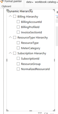

Thanks for answers.
This is a result which i am getting from my code:
and your dax it is not working:
It is not groupimng hierarchies in slicer.
did you check the youtube attached?
Best,
Jacek

Ok,
so I did :
and now make the slicer and still ResourceType is before Subscription.
It is not working:
Best,
Jacek
