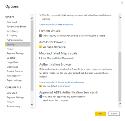

File -> Options and settings -> Options -> Global -> Security ->  Authentication Browser -> Use my default web browser (check this box)

File > Options and settings > Options > Global > Security > (scroll down) Authentication Browser > Check the box "Use my default web browser"

A new Power BI option enables the possibility to use your default browser to load the oAuth page.
If the authentication window for Power BI (or data connector) can't open for some reason, this option allows you to use your default web browser to authenticate instead.
