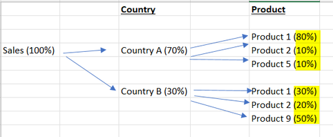

power bi decomposition tree: % of subtotal
decomposition-tree gives only the option showing share of an element in % of COMPLETE-TOTAL.
Is there an trick/option, that I can show the percent of the direct parent-level ?
(It is very important that user has to have further full flexibilty changing the chosen/selected elements (not fixed elements-structure as in other solutions).
My Goal-structure: (user can change element-structure complete free)
For me this feature (% of subtoatl) is absolutely necesarry for user-acceptance.
Kind regards
Rainer
@rainerpowerbi , You have to use isinscope and switch measure, but remember, you can not have it fully dynamic , which means if you swap country and product it might not work
Please find all measures
M1 = divide([measure], calculate([Measure], allselected())
M2 = divide([measure], calculate([Measure], filter(allselected(Table), Table[Country] = max(Table[Country]) ))
or
M2 = divide([measure], calculate([Measure], allselected(Product)) //if product is separate dimension
Switch( True() ,
isinscope(Product[Product]), [M2],
[M1]
You can extend the switch with more conditions
https://www.kasperonbi.com/use-isinscope-to-get-the-right-hierarchy-level-in-dax/

Hi amitchandak,
thanks a lot for your answer !
I regret that in your and other solutions the user has no option to place the levels IN A COMPLETE FREE STRUCTURE. I hope that Microsoft will provide this feature (% of subtotal)  as soon as possible to increase user-acceptance.
