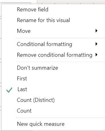

Thanks Paul, but still had the issue because I wanted to group even Yes or Not, where each Defect ID is suming #TCs Blocked in only one row.
What I did, is based on your suggestion, I calculated a column Yes or No, and on this new column I choose not count, not summarize, but Last (as attached). Thanks!!!Capture.PNG
