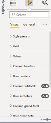

iam facing the same issue but iam not able to find the word wrap filed in the latest version of power bi desktop can please suggest me which field i need to see.
It is called Text Wrap now--the easiest way I'm finding to deal with the new layout is using the search bar in the formatting section.
