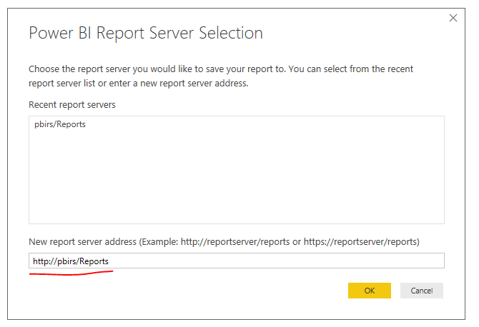

I tried what you have mentioned, yet no luck.
I have attached a screenshot of the issue.
Any help will be greatly appreciated.
Thanks,
Deepthi

I too had the same problem, It was due to miscofiguration of urls. While Setting up powerBI server, theWebservice URL and Web Portal URL was set to same which caused the error. Modifed the URL's and used Web Portal URL to save the reports.
