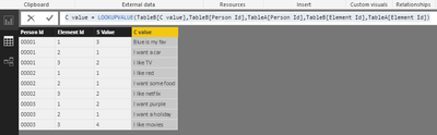

I tried the method above of a New Table TABLE A and TABLE. B .. it did not work.... i believe it did not work, because i did not explain the data in entirety in my example, ... Each Person Id can have many "Element Ids" ,,, so below is a better version of the data i have and what i want to achieve ... is there a way to do it ?
Person Id             S or C Type            Element Id               Value
00001                  S                            1                                3
00001                  C                            1                               Blue is my fav
00001                  S                            2                               1
00001                  C                            2                               I want a car
00001                  S                            3                                2
00001                  C                            3                               I like TV
00002                  S                            1                                1
00002                  C                            1                               I like red
00002                  S                            2                               1
00002                  C                            2                               I want some food
00002                  S                            3                                2
00002                  C                            3                               I like netflix
00003                  S                            1                                2
00003                  C                            1                               I want purple
00003                  S                            2                               1
00003                  C                            2                               I want a holiday
00003                  S                            3                                4
00003                  C                            3                               I like movies
i want to convert this to a table with following format:
Person Id             Element Id                S Value             C Value
00001                   1                              3                        Blue is my fav
00001                   2                              1                        I want a car
00001                   3                              2                        I likle TV
00002                   1                              1                        I like red
00002                   2                              1                        I want some food
00002                   3                              2                        I likle netflix
00003                   1                              2                        I want purple
00003                   2                              1                        I want a holiday
00003                   3                              4                        I like movies
Thank you for your advice.

Hi @ajay-sformula,
Each Person Id can have many "Element Ids", you just add a "Element Ids" in TableB, then lookup Cvalue based on "Element Ids" and "Person Id".
1. Create TableA and TableB.
TableA = SELECTCOLUMNS(FILTER(Test1,Test1[S or C Type]="S"),"Person Id",Test1[Person Id],"Element Id",Test1[Element Id],"S Value",Test1[Value])
TableB = SELECTCOLUMNS(FILTER(Test1,Test1[S or C Type]="C"),"Person Id",Test1[Person Id],"Element Id",Test1[Element Id],"C value",Test1[Value])
2. In TableA, create a calculated column using the formula and get expected result.
C value = LOOKUPVALUE(TableB[C value],TableB[Person Id],TableA[Person Id],TableB[Element Id],TableA[Element Id])
In addition, for second solution in Query Editor, please click both "S or C Type" and "Element Id"->Pivot column->value and don't aggregate, you will get right results.
Angelia
