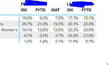

i hope to create a conditionally formatting based on individual column of the matrix table below (preferrably gradient color scale), i.e. 3M within product P, not 3M across both Product P and Product LA...anyone knows how to write a formula for that?

Thank you, the example file you provide is helpful, but i still couldn't get it right...
Tried to replicate from your "Color" measure to mine as below, did i get it right? the aim is to compare to the total value of "3M G%" under Product P, i.e. if it's greater than 15.3%, color green, if below, orange, if negative, red

I think i need to replace this yellow bit with a new measure that calculates 3M G% ignoring the row label...which is "Account" in this case....can you help with this formula? Thanks again!

Hi Shafiz
thank you! however, sorry i didn't explain the measure of "3M" properly, it is a calculated value for rolling 3 months vs LY, i.e. Oct 24+Sep 24+Aug 24 vs Oct 23+Sep 23+Aug 23....so the formulas containing 'calendar[quarter]' would not work.....plus i also need to replicate this conditional format process for the value of "Fiscal year to date vs LY, and rolling 12 months vs LY too......
The formula I have provided is just an example, how could you color background of specific measure of a specific column. It does not matter how your measure is evaluating. It is a matter which column and which measure. You can compare measure with other measure or fixed value for gradient color scale. As I understood from your post. Also, calendar[quarter] is my column name to demonastrate the scenario. Your column name is different (from the picture, i can see it is molecule). You need to replace column name and measure name accordingly.
