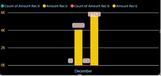

I am trying to consolidate same set of data from two different tables into one graph, just like a pivot table in excel.
I have dates on the x axis, when i try to add number of items (just filtered numbers summed up of certain category) it produces two different bars.
How do i get this to work?

Hi @JordanJSA
I have tried this Measure but it doesn't seem to work. I would like to see all amount columns consolidated in one Bar.
The other bar would consolidate number of instances into one. hope it makes sense.
I have tried your solution and this is how my data looks now.
