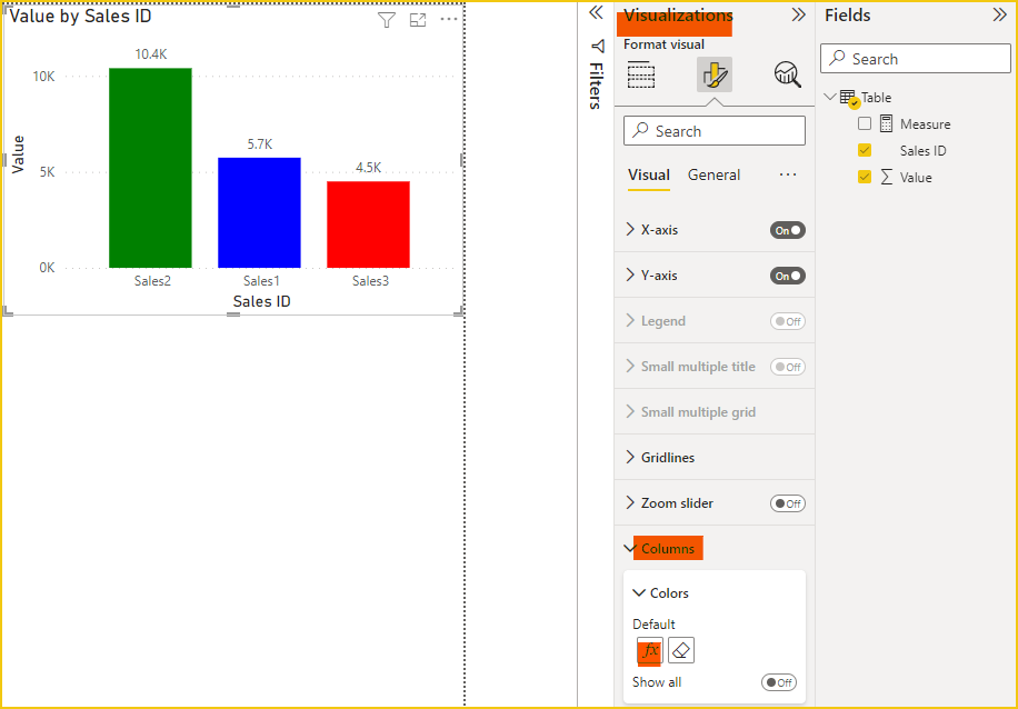

Hello All,
I have a clustered bar chart and having different values
Sales1, Sales 2, Sales 3 .
Now I need to change the color for each bar based on thier value, But I see there is no custom color option for this chart.
Could any one suggest how to do this
    4 years ago
    Hi Anonymous ,
    Please use the IF() or SWITCH() functions to create similar measure and use it as a conditional format for visuals.
    Measure =
    VAR _total = SUM('Table'[Value])
    VAR _colour =
    SWITCH(
        TRUE(),
        _total>=5000 && _total<=6000,"Blue",
        _total<5000, "Red",
        _total>6000, "Green"
    return
    _colour
    Attached PBIX file for reference.

    you can change the color  by going to the Format your Visual then go columns and create a expression for your data bar color
