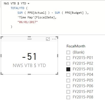

  • v-haibl-msft's avatar
    v-haibl-msft
    stben
    What is your PPG table like? I tried with PPG and Time Map as below. It seems that your measure can return the right result. These two tables have relationship with the Date key.
    (20 + 17 + 88) – (81 + 6 + 89) = -51
    Herbert
