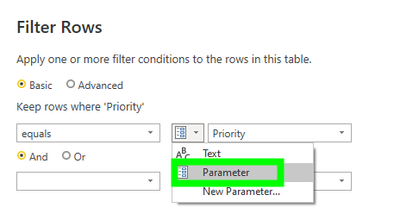

Another trick you can do is look at your data and find a field that can be used to filter the data down like a date field or some sort of dimensional information (like color, age, type, source) create a parameter in Power Query (Transform Data) using the value from the field and filter it down in Power Query. Then once you've published you can remove the parameter set from the service. That way you can still develop using a subset of the data and not be limited to just that filtered down data. Make sure to uncheck required and to set type to something other than Any so that you can remove the parameter.
Then filter the field where it's equal to the parameter
Then after you've published you can remove the parameter, and refresh the data source again.
