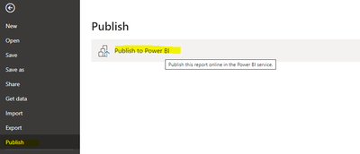

Bibi_Rukshar
Hi Everyone,
A solution is to publish the power bi desktop on your workspace and then, on the workspace you have the option of exporting to pdf.
