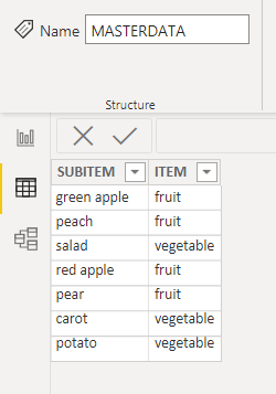

@Greg_Deckler here is a popularization of my problem with fruits and vegetables.
If you have a look, it would be greatly appreciated.
NB : The column Stock is the sum of the field STOCK in the table STOCK

Actually, as described, the crosstable should filter MASTERDATA and STOCK because in CROSSTABLE we have just "peach" and "salad".
We can see in pictures of my former post that when I ask for each month to count the distinct SUBITEM :
- in MASTERDATA, the result is 2 for each month (peach and salad) because there is no notion of date in MASTERDATA and so the 2 subitems appear for all period. That part is logical.
- in STOCK, the result is 4 for January, 3 for February and 3 for March. Those results corresponds to the entire table. So, why STOCK has not been filtered by the SUBITEM coming from MASTERDATA (ie. peach and salad) ? I was expecting the following result : 2 for January (peach and salad), 0 for February, and 1 for March (salad).
(NB : My actual power bi is way more complex than that, and I agree that the example with fruit and vegetable doesnt make sense, but it was just to duplicate the problem with more simple and less data).

in the first case, you have explained the result of MASTERDATA and I agree with what you have exposed, but my question is about STOCK. Why the green relation in the picture below is not applied ?
