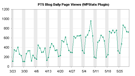

Howto add visualization of weekends?  Best would be to colorize weekend sections the line itself.  But this method below would be helpful too.
Please refer to picture below:
Visualize weekends.
Thank you!

  • weekendsOr adding a bar like this, but coloriznig the line is prefereable.  Thanks!

      Colorizing the line is preferable, but this bar is ok too, how to do this?

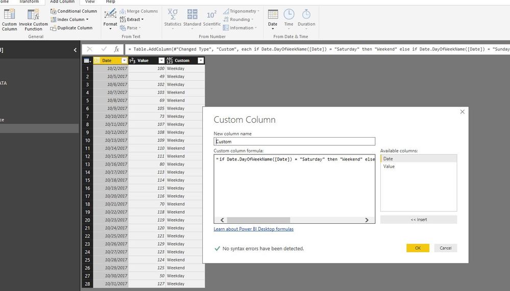

    If you use the ChrisHaas’s formula to create custom column, you would need to change the formula to the following:
    if Date.DayOfWeekName([Date]) = "Saturday" then "Weekend" else if Date.DayOfWeekName([Date]) = "Sunday" then "Weekend" else "Weekday"
    Alternatively, you can create a calculated column using DAX below. And you can create Line chart or column chart as shown in the following screenshots.
    CheckWeekend = IF( OR(WEEKDAY(Table[Date])=1,WEEKDAY(Table[Date])=7),"Weekend","Weekday")
