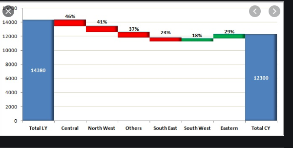

Hi Kelly, I got an email from you asking if the waterfall question had been answered.   I appreciate your reviewing what I had done, but...  Not quite yet.   In a followup, I responded with an example showing a begin value.WFExample.PNG
I have been doing additional reading - and I think this is a limitation of PBI.   I found a reference, asking to vote on it - and as I dug, there were multiple like kind requests.  So, unless something new has recently transpired - I'm not hopeful.  But - maybe you have some magic 🙂
thank you@
Thanks, but not quite...  I found an WF image with the concept I want to shoot for.   In my example, the first bar would be the 2018 value of 13.33 and the red/green bars represents the 2019 changes in Labor, Supplies, and fuel.  The ending bar would add up to $17.WFExample.PNG
