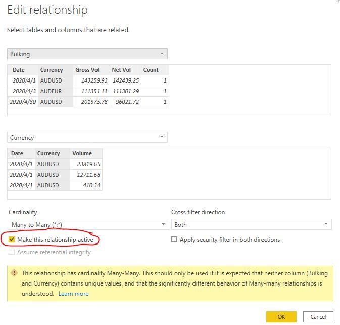

Hi @artblakey ,
Please create the relationship between Bulking and Currency table based on field "Currency".

Hi @artblakey ,
Please active the relationship which be created between Bulking and Currency table based on Currency field and de-active or remove the left 2 relationships.
Rena
