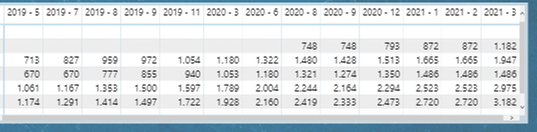

Good afternoon, the company where I work I need to make a report with the percentage variation in raw materials over the last three years. The downside is that raw materials don't go up every month so there are months when I don't have data.
Raw material value table
Columns: Year/month
Rows: Prices of different raw materials
The table shows that for example during October and November 2020 there was no price update.

In other words, in this case I would be short to obtain the percentage change between September 2020 and December 2020 (among several other periods).

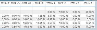

Thank you very much Xiaoxin for the help!!! It was just what I needed!!!
As a whole I adapted the date in the currDate variable and it worked perfectly. The code looked like this to me:
