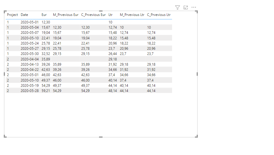

I am trying to create DAX measures to get values from previous transaction dates. On left side is Transactions table where is should be able to calculate LTR and EUR values from previous transaction dates. My goal is on right side where I have marked with colours the results which I would like to get ("Previous Ltr" and "Previos EUR"). I have spent so many hours trying to get this working so it would so great if someone could help me?

  • Hi, K_LLI
    I prefer to  use calculated column as below:
    C_Prvevious Eur =
        MAX ( Transactions[Eur] ),
        Transactions,
        Transactions[Date] < EARLIER ( Transactions[Date] ),
        Transactions[Project] = EARLIER ( Transactions[Project] )
    C_Prvevious Ltr =
        MAX ( Transactions[Ltr] ),
        Transactions,
    You  can also try measure as below:
    M_Prvevious Eur =
    VAR previousdate =
            MAX ( Transactions[Date] ),
            FILTER (
                ALLEXCEPT ( Transactions, Transactions[Project] ),
                Transactions[Date] < MAX ( Transactions[Date] )
            FILTER ( ALLEXCEPT(  Transactions,Transactions[Project]), Transactions[Date] = previousdate )
    M_Prvevious Ltr =
    VAR previousdate =
            FILTER (
    Please check my attached pbix file for more details.

  • v-easonf-msft's avatar
    v-easonf-msft
    Hi, K_LLI
    C_Prvevious Eur =
        Transactions,
    C_Prvevious Ltr =
        Transactions,
    M_Prvevious Eur =
    VAR previousdate =
            FILTER (
    M_Prvevious Ltr =
    VAR previousdate =
            FILTER (
    Community Support Team _ Eason
