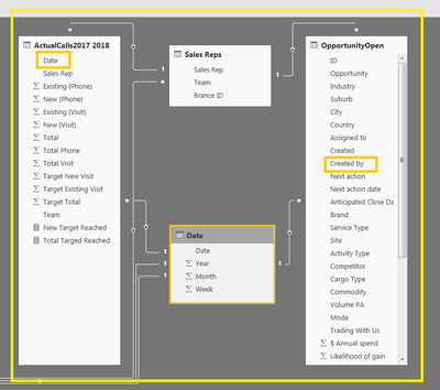

You can make a time dimension without using summarize. Try making a new table with this:
TimeDim = CALENDAR(FIRSTDATE(Table[Date]);LASTDATE(Table[Date])).
Then you can link your tables to this new table, and slice on that. Let me know how it goes.
Best,
Martin
Thanks for the response. I am going to work on pulling in a table of unique values of date to create a relationship. Now I asked this in another thread and I haven't gotten a response but it is somewhat related. I want to use the date slicer to bring in data based on a date range between the two date columns Start Date / End Date. If you could take a look...
https://community.powerbi.com/t5/Desktop/Filtering-within-a-date-range/m-p/227773#M101499
