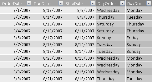

    Two CALCULATE are required in this case: the outermost CALCULATE applies the USERELATIONSHIP to the innermost CALCULATE, and the ALL ( DimDate ) filter removes the existing filter that would be generated by the context transition. The innermost CALCULATE applies FactInternetSales to the filter condition. Thanks to the active USERELATIONSHIP, its filter propagates to the lookup DimDate table using the DueDateKey relationship instead of the OrderDateKey relationship. The result is visible in the following screenshot.
    ResultRelated
    Though this syntax works, it is strongly advised not to use it. Indeed, it is hard to understand and it is easy to write incorrect DAX code here. A better approach is using LOOKUPVALUE instead, which does not require the relationship at all.
