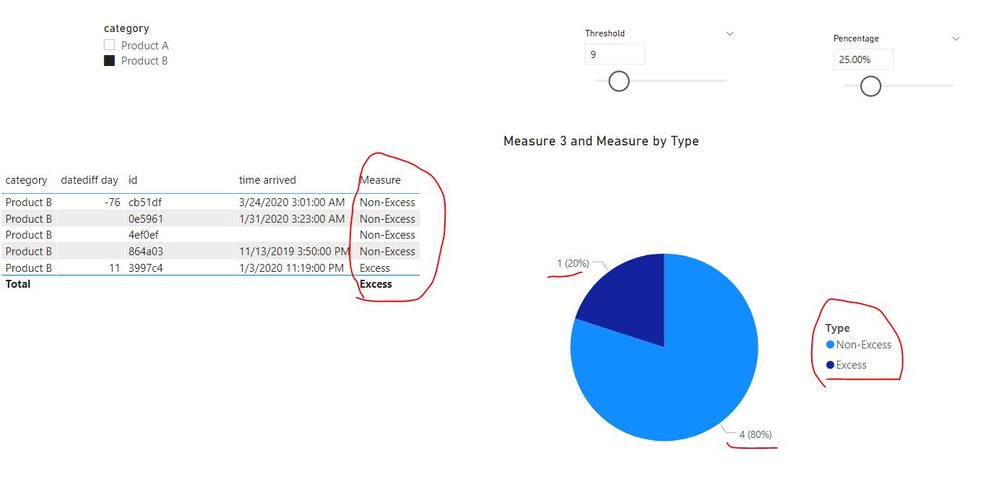

First, measure can be affected by filter/slicer, so you can use it to get dynamic summary result in a visual by its row context. So you could not put it into Legend of a visual.
https://www.sqlbi.com/articles/calculated-columns-and-measures-in-dax/
Second, for your case, you could this way as below:
Step1:
You need a table that contains all the result of this measure, for example:
Step2:
Create a measure like this logic:
Measure 3 = var _table=FILTER(CROSSJOIN(ADDCOLUMNS('Fact',"_type",[Measure]),'Type'),[_type]=[Type]) return COUNTROWS(_table)You could also use SUMX/MAXX/MINX instead of COUNTROWS in the formula
Result:
here is sample pbix file, please try it.
Lin
Step1:
Step2:
COUNTROWS(_table)
Result:
Lin
