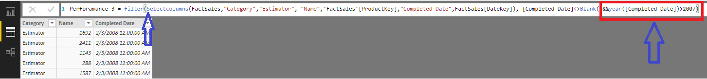

        If the formula is complete, the UNION isn't correct there. Please refer to the snapshot below.
        Can you share a sample if you still have issues?
        Use-WHERE-condition-in-DAX-with-Union-and-Selectcolumns
