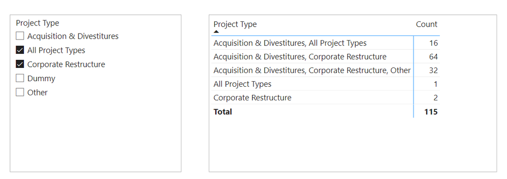

Hi @taylorpeter55, no worries, good to hear from you!
I had a look through the URL filter documentation and there don't appear to be any substring-based filtering options. The 'in' filter just checks for an exact match with any of the items between the brackets.
While Power BI URL filters are based on OData filters, Power BI has a more limited set of options unfortunately.
I would instead recommend adjusting the semantic model so that you can use an 'in' filter on another specially constructed table. I have attached a PBIX as an example.
Here are the steps I would suggest:
1. Create a new table, which I called 'Project Type Concatenated'. This contains the distinct values from AutomationLibrary[Project Type] (each of which is a comma-delimited list):
2. Create another new table, which I called 'Project Type Individual'. This contains all combinations of the original Project Type Concatenated values and the individual Project Type values. I created it using the Splitting function in Power Query:
3. Create relationships as follows
(note the bidirectional relationship between 'Project Type Concatenated' and 'Project Type Individual') :
4. Now, you can apply a filter on 'Project Type Individual'[Project Type], and this will have the effect of selecting any of the original Project Type column containing any of the selected individual Project Types:
5. For the URL filter, apply the 'in' filter to 'Project Type Individual'[Project Type]:
filter=Project_x0020_Type_x0020_Individual/Project_x0020_Type%20in%20(%27All%20Project%20Types%27,%27Corporate%20Restructure%27)
Does something like this work for you?

@OwenAuger Apologies for the delay in replying, I have been out of the office with no access to my laptop.
Thanks so much for your response, I really appreciate it.
I've tried your URL filter for 'All Project Types' and 'Corporate Restructure' and it correctly filters on rows with these categories called out individually:
However, I was hoping (rightly or wrongly) that the IN function would also filter on rows that contain one of the above values in addition to other categories.
Example:
Is the IN function capable of identifying these rows? Or is there a different function that I could use to include these rows?
Ideally, I would want to see all 5 rows in the above 2 screenshots included by the same URL filter (i.e. include any rows that contain the category rather than an exact match).
Thanks in advance for any further guidance you can provide.
Pete
