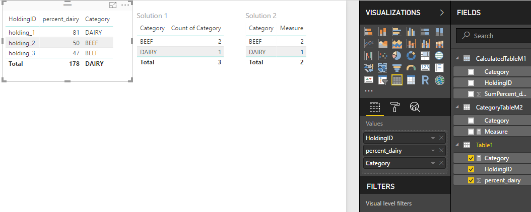

  • Hi justinMcC,
    Here is two solutions based on your data and WolfBiber's idea.
    1. Calculated table.
    CalculatedTableM1 =
    	ADDCOLUMNS(
    		SUMMARIZE('Table1',
    				Table1[HoldingID],
    				"SumPercent_dairy", sum(Table1[percent_dairy])),
    				"Category", if([SumPercent_dairy]>=80, "DAIRY","BEEF"))
    2. Measure.
    1) Create a new table "Category" by "Enter data" with data "Beef" and "Dairy". (don't create any relationships)
    2) Create a measure.
    Measure = var cat = min('CategoryTableM2'[Category])
    	return sumx(
    		ADDCOLUMNS(
    			SUMMARIZE('Table1',
    				Table1[HoldingID],
    				"sumTemp", sum(Table1[percent_dairy])),
    				"categoryTemp", if([sumTemp]>=80,"DAIRY","BEEF")),
    				if([categoryTemp] = cat, 1,0))
    Turning_a_measure_into_a_column

    Hi justinMcC,
    CalculatedTableM1 =
    	ADDCOLUMNS(
    		SUMMARIZE('Table1',
    				Table1[HoldingID],
    2. Measure.
    	return sumx(
    		ADDCOLUMNS(
    			SUMMARIZE('Table1',
    				Table1[HoldingID],
    Dale
