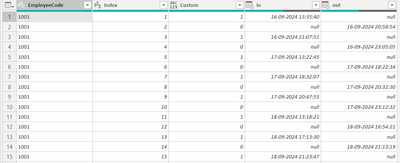

Hi Srishti_Pawar - Yes, you can achieve this using a pivot in Power Query
Add an Index Column to the data set (from the "Add Column" tab).
Create a Custom Column to mark "In-Out" pairs by creating a new column that increments by 1 only for "In" records. This will serve as a group identifier.
if [Direction] = "In" then 1 else 0
now select the direction column and use pivot transformation
Verify that each "In" record is paired with the correct "Out" record. The index or grouping step ensures that "In" and "Out" logs correspond correctly.
Hope it works
Hi, I tried using this method but doesn't work. I'll have to merge the table on the basis of index column after replicating it.
