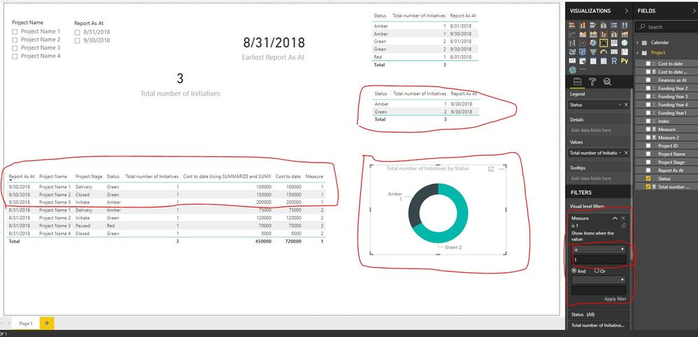

Since you don't select any Report As At from slicer.
for each row in the lower left corner of table visual, Max( Project[Report As At ])="Calendar"[Date] , so Total number of Initiatives is 1 for each row, but for the total,  Max( Project[Report As At ]) is 2018-09-30, so It just calcuate the date is "2018-09-30" and the result is 3.
And the table visual in the top right corner, it is an aggregate summary table visual for the table visual in the lower left corner.
and if you select the doughnut chart and change it to table visual, you will find it is the same visual as the table visual in the top right corner.
Second
You may try to use this formula to add a measure
Measure = IF(CALCULATE(MAX(Project[Report As At ]),ALLSELECTED(Project))=MAX(Project[Report As At ]),1,2)
then add it into the visual level filter and set filter result is "1" as  below:
BeforeBeforeAfterAfter
Here is my demo pbix, please try it.
 CALCULATE(MAX(Project[Report As At ]),ALLSELECTED(Project))  returns the max Project [Report As At], It's going to have the same effect as calculated column ISLatest
And measure is dynamic and column is static.
for example:
If you only select Project Name 4, column still returns 2018-09-30 but my measure will return 2018-08-31
and it will lead to error result.
Your measure in the doughnut chart will return blank valueYour measure in the doughnut chart will return blank value

Can you please try and access this link? I have never tried sharing a link outside of my office networkimage.png
Basically, when the"report as at" slicer is unselected (refer image above), the visual ideally must display the status of only 3 projects as one of them closed in the previous reporting period and is no longer required in the current cycle. Likewise, selecting a past reporting cycle, such as 31/08/2018, should display all 4 projects
So if a project is selected, it should display the status for the current reporting period. The problem I am facing is that, selecting a single project, e.g Project 3 which was reporting RED in August and AMBER in September, shows both the categories in the visual (as below) instead of only AMBER as that was what Project 3 was reported in September
