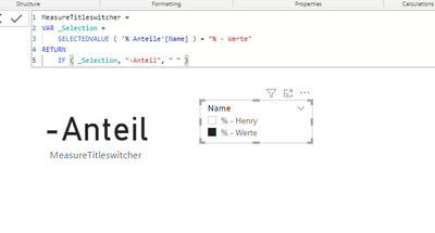

Hi @Anonymous ,
The reason for the error is that "True" is a Text type, and the type returned by _Selection is a Boolean type, which cannot be compared directly.
The formula needs to be converted as follows:
MeasureTitleswitcher =
VAR _Selection =
SELECTEDVALUE ( '% Anteile'[Name] ) = "% - Werte"
IF ( _Selection, "-Anteil", " " )
VAR _Selection =
VAR _LogicTest =
VAR _SelectedKPI =
SELECTEDVALUE ( 'KPI'[Name] )
_SelectedKPI & " "
& IF ( _Selection, "- Anteil", " " )
If the problem is still not resolved, please provide detailed error information and let me know immediately. Looking forward to your reply.
Henry
