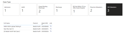

The details of the card visual, I want to show in table. Upon clicking on the respective card, I need to show respective data in the table which is also on the same page. here was the design of the report
Do Bookmarks and Buttons will be enough to achieve this requirement? I will create a bookmark with relevant filters and add a to the button, size it as of that of card. Upon clicking on card...the data in the table will be filtered...Can you help me if I can do like this?

I know of two ways to do this - the first is with an invisible button over each of the cards, with the button action to go to a bookmark which filters the table and other visuals to that view. This does work and is reliable, but it tedious work to set up and a commitment to continue adjusting these bookmarks as you add or replace visuals. Here's an introduction to this approach.
Another option is to use the new button slicer released in the November Power BI release, currently in preview. Here's how that would look, with the limitation that it is currently in preview, and the number of cards you can show is static, with options to scroll or < > arrows to show additional cards.
Here's an quick example using the your use-case:

@pavanmanideep , Data In the table will not filter, You need to create that many table and hide and show them as per need. The button should be transparent and cover card
refer: Clickable cards in power bi using sync slicers & bookmarks -04  https://www.youtube.com/watch?v=dHMfLxPALnw
