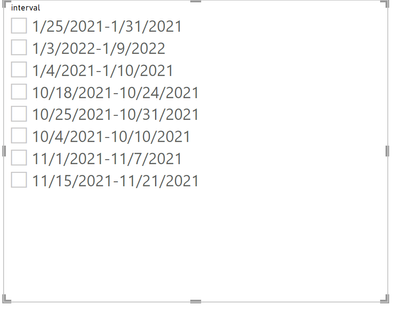

Hi, I am trying to sort some time intervals in a slicer. They each represent a week, yet they are in a very strange order. I think PBI interprets them as text instead of time interval, so each number is sorted like characters.
I want to sort them in chronological order. I think based on the first date should be good enough. May I ask how I can do that? Thank you!

    From this slicer here....

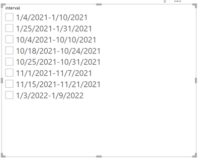

    ...I was able to sort them and ended up with this:
    I first created a new column in power query where I parsed all the values before the delimeter "-" of the interval column, ending up with the dates in text format. I then changed the type of the new column to date. Finally, I used the "sort by" function to order the intervals by the new column as seen in the link of the previous answer.
